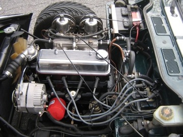

13_complete assy.jpg (49.19 KiB) Viewed 37637 times
11_mounted+wired boxes.jpg (36.73 KiB) Viewed 37640 times
2_pulley and vr sensor.jpg (34.28 KiB) Viewed 37641 times

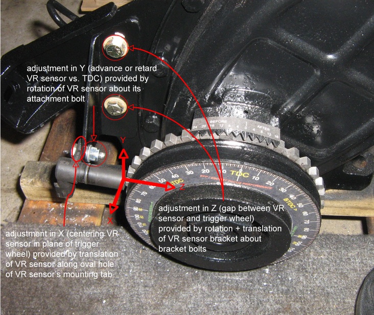

I'm including some more photos of my installation.

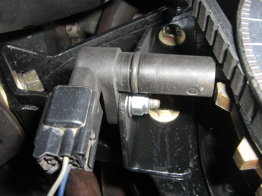

This photo illustrates the adjustability of the VR sensor in 3 important degrees of freedom: sensor to teeth gap, sensor centering and sensor angle relative to TDC.

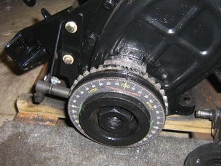

mounted VR sensor
close-up of VR sensor mounted on its bracket, which is mounted to the front engine plate

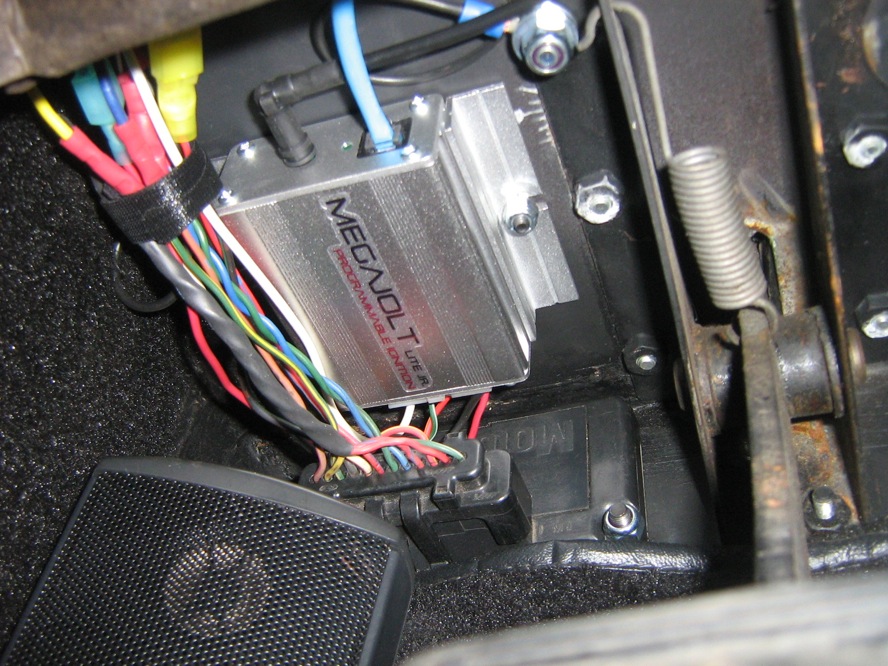

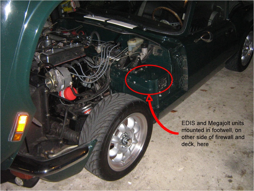

EDIS and Megajolt box location
The EDIS and Megajolt boxes are mounted high in the left side footwell, on the inside surface of the firewall and the underside of the master cylinder mounting deck.

Megajolt and EDIS
Megajolt and EDIS, mounted and wired-up

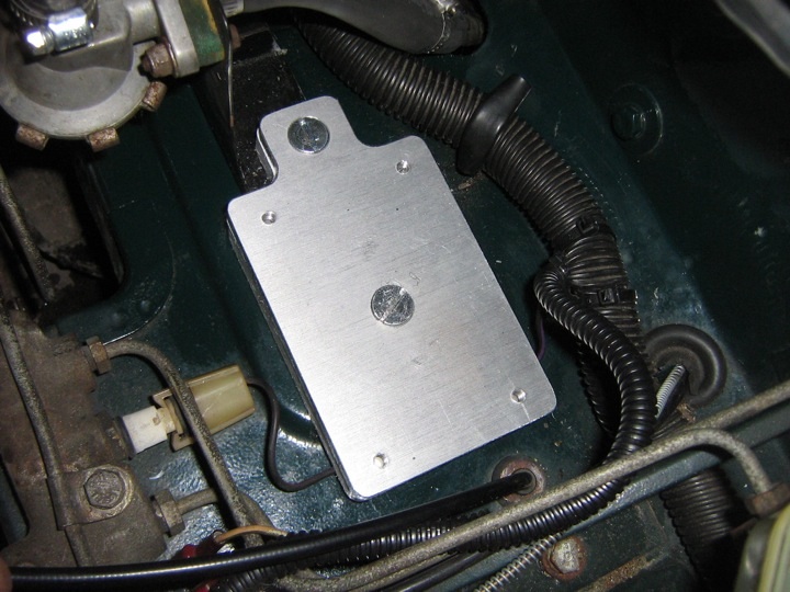

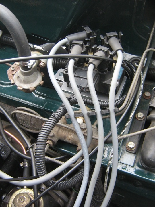

I fabricated an interface mounting plate to allow mounting of the coil pack at the same location as the original coil using the original holes for the coil mount. The plate has 4 threaded holes to accept #10-24 machine screws for holding down the coil pack, and is attached to the car with two flat-head machine screws that go through the holes in the deck for the old coil mount, which also secure the bracket holding the heater control valve.
coil pack interface plate
starman
Posts: 16
Joined: Sun Dec 21, 2008 4:56 pm
Post by starman »
Coil pack, mounted and wired-up.
coil pack
coil pack

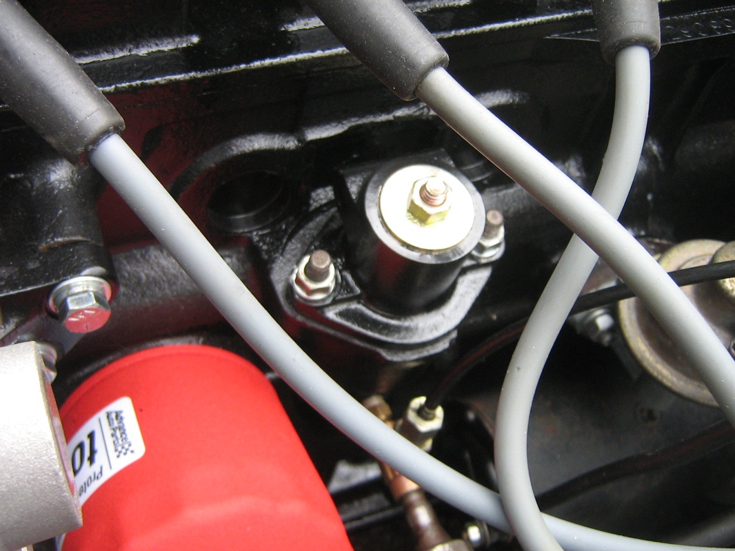

The old distributor pedestal is retained to properly constrain the camshaft-driven oil pump drive gear. The distributor shaft hole is plugged with a rubber expandable freeze plug.
distributor close-out

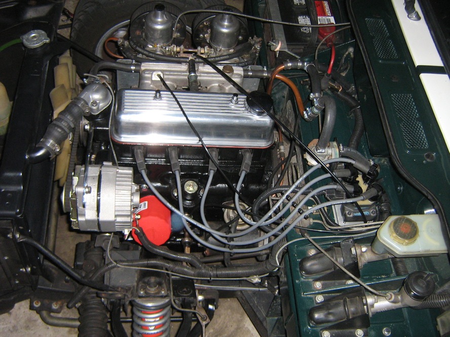

The complete, operational Megajolt Lite Jr.-equipped engine in my 1978 Triumph Spitfire 1500.
complete configuration

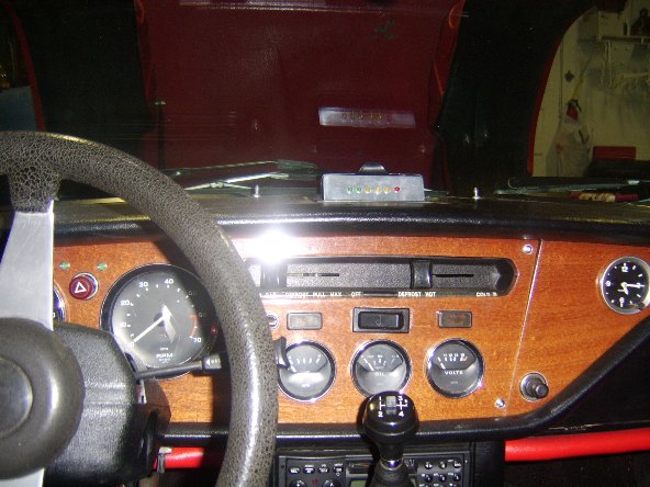

Starman,
Nice job on the installation. One thing I found after installing in my '77 spitfire, was that my tach was not correct so I made a LED tach and placed it in the ash tray (see photo). It runs off the six outputs. I like it there because I can flip the cover down when I don't want to see it.
