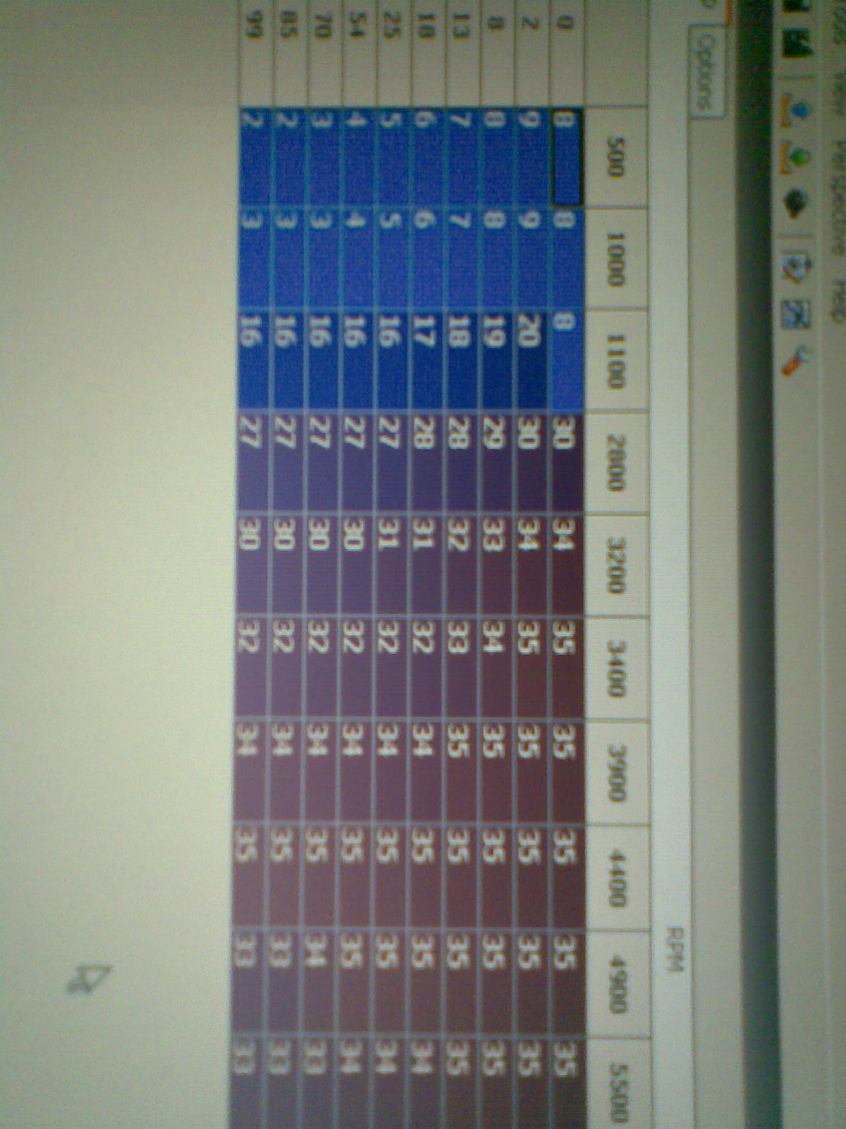

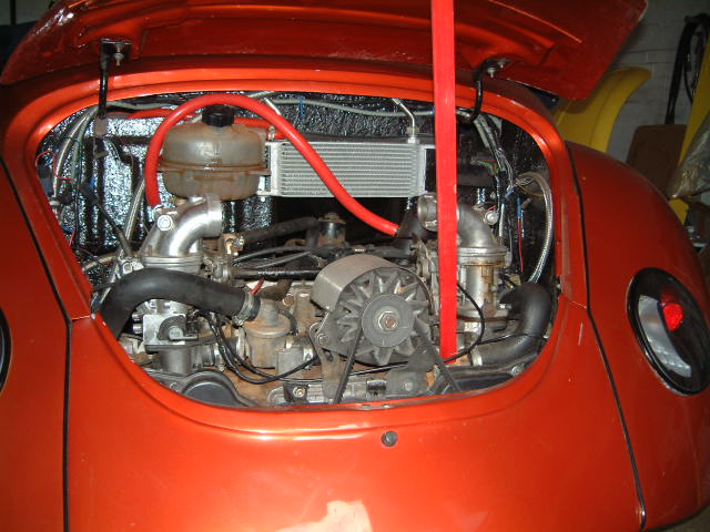

I intend to hopefully have my map finalised next week i am runing tps at the end of the throttle shaft.are you using tps? i will post a screen shot of the map when finished.
finished asembly.jpg (49.63 KiB) Viewed 52897 times

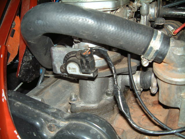

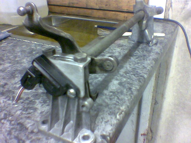

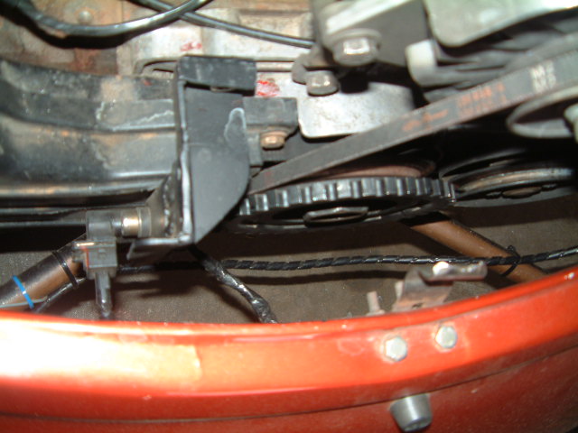

Yes I put mine on the end of one carb,it was easier to fit then I thought,I just need to tighten the pulley up a bit more bcos as you know they dont have any location! & it has worked loose once.I'll add some pics on here when I figure how to.Cheers,Pete

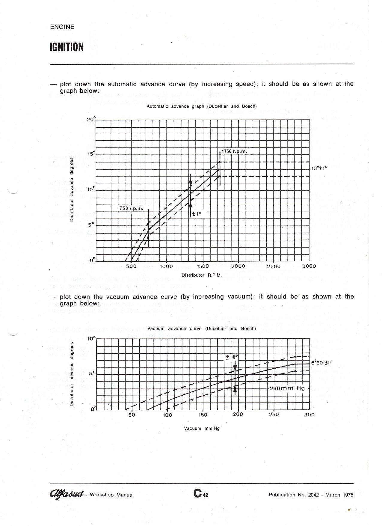

I'm working on a map for my alfa 33 1.7 8 valve, they're probably quite similar.
I found a graph of the ignition curve for the early Alfasud - probably 1300 (printed in 1975!). Although they state 8'@idle - 22'@2000rpm and 36'@4500 this graph looks really low - can anyone explain this? (I'll try and attach a scan)

Heres the crank pulley
pulley on engine.JPG (78.24 KiB) Viewed 52792 times
TPS on carb spindle
TPS on carb spindle
TPS on engine.JPG (75.21 KiB) Viewed 52792 times
Alfa engine.JPG (77.18 KiB) Viewed 52792 times

map
Post by alfa boxer »
hope this helps
Alfawiz
Posts: 6
Joined: Thu Sep 03, 2009 9:56 pm
Post by Alfawiz »
Cheers mate,I will put that in,I just need to open the jets out a tad more as shes still running lean at the mid to top end
