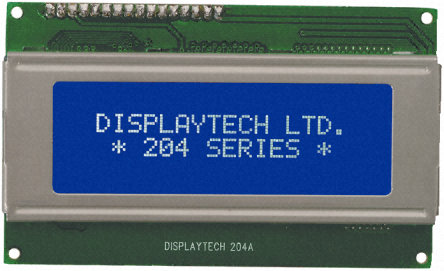

Right been and ordered my screen today. I ordered one of these and will be picking it up tomorrow http://uk.rs-online.com/web/search/sear ... &R=5326818 It can have 20 characters on 4 lines in total so once i have it working/talking to the arduino then i will have to figure it some screen info for it to produce. It could create a bar graph as an indication of output with a title at the beginning such as rpm or read figures. With 4 lines it could have RPM, engine temp, map/tps value/percentage, current advance and also maybe flash a warning such as OVER TEMP WARNING (if engine is over heating) KNOCK WARNING (if a knock sensor is fitted). More thinking on this front.

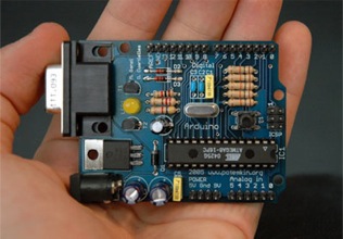

Along with the screen i ordered an arduino http://uk.rs-online.com/web/search/sear ... rm=6961655 (you can get these as clone boards a little bit cheaper off ebay but not a great deal cheaper).

Right so i now have purchased an arduino duel.... whatever it is. There seems to be quite alot of help on the arduino forums and so far i have managed to get some LED lights to flash (wow you say), but more practice will encourage more complicated systems.
I also have a 20 x 4 LCD screen http://uk.rs-online.com/web/search/sear ... &R=5326818 which i have already managed to blow the background LED (no current limiting resistor), but then couldn't find anywhere saying it needed one (silly me). At only £8 it is hardly gonna break the bank, but i'm sure i can bodge a new LED as a backlight.

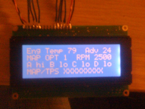

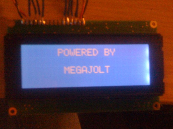

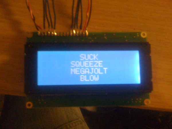

A bit more, but slow, progress with the LCD. The first LCD didn't seem to work so i ordered another 20 x 4 from somewhere else. After getting it to display 'Hello World!', I have now created a couple of example screens on the LCD whilst i practised (shown below). It took me a while to learn how to program different screens and then making the arduino change screens in 1 program.
My current design is to have a single flashing cursor for 5 secs (so it looks like its booting up), then displays "POWERED BY MEGAJOLT" and finishes with the info screen on constant loop. I found anything less than 0.5s refresh rate (with most characters utilised) a couple of the lines of the LCD to flash when looked at an angle and at really high refresh rates the same lines has a strange scrolling effect on the pixels of the characters.
Check out the pics so far
