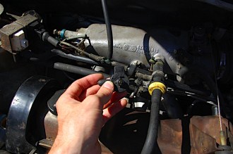

A better picture here (with hose and engine cover removed):
Something like this. This is the CIS injection model. The carb models have a similar one on the right hand side of the manifold. This T piece is also a valve to store vacuum escaping from the Vacuum reservoir of the brake servo when in low vacuum MAP (possibly engine stall) and requiring to still brake.
You may find similar ones on most models of VW's (petrol).
VW map tap (330 x 219).jpg (21.82 KiB) Viewed 13488 times

Thanks for that - the one I'll make will be very similar to that. There's already a valve in the vacuum line for the purpose you mention
