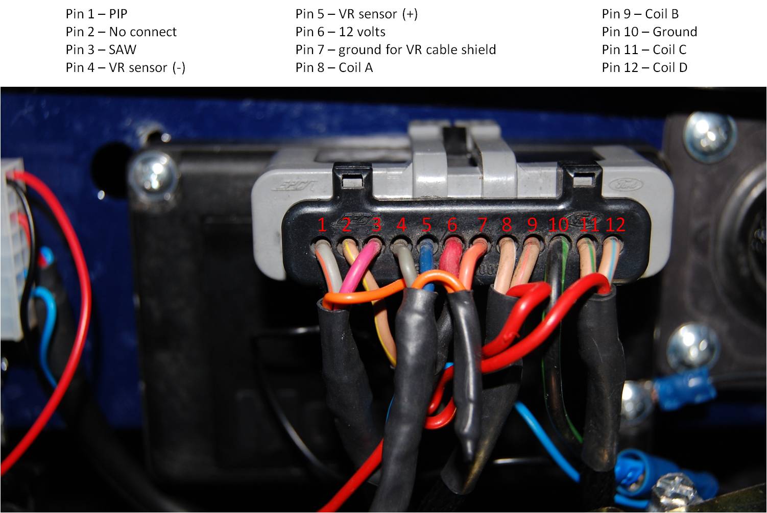

I’ve attached a photo of the connector wiring, hopefully someone can confirm if this is correct or not…
- Pin out of EDIS8
- EDIS8 pin out.jpg (126.1 KiB) Viewed 20942 times
Spockie-Tech
- Posts: 152
That looks correct to me.

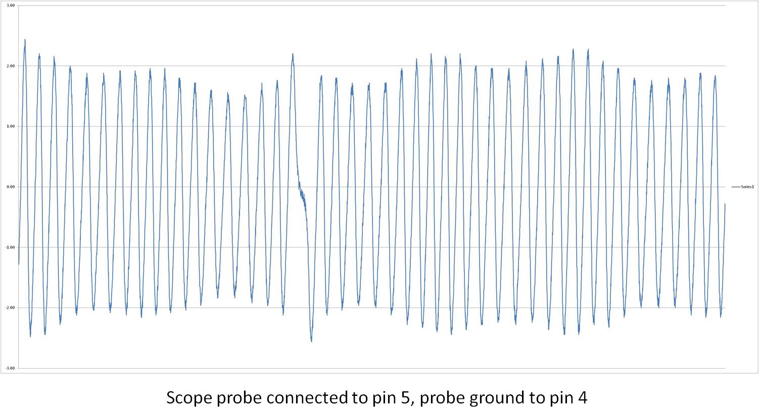

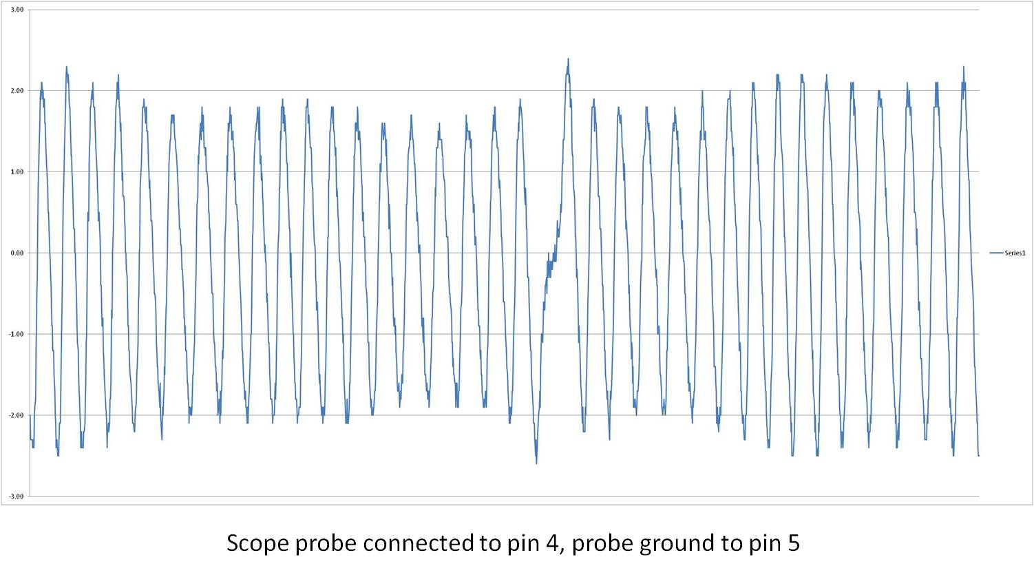

I’ve managed to get an oscilloscope from work and measured the wave forms as per the images.
Fortunately the supplier of the EDIS module has a bench test system and has offered to test the EDIS to verify the functionality.
- Wave form 1
- Picture1.jpg (130.83 KiB) Viewed 20900 times
- WAve form 2
- Picture2.jpg (117.36 KiB) Viewed 20900 times

Well, that also looks good to me.. 'Scope pics ! wasnt expecting them !
Theres a slight amount of variation in the peak levels there that is suggestive of a small amount of runout in the wheel or wobble in the sensor mounting (or it could just be AC noise), but it doesnt look like enough to disturb the signal.. You can clearly see tooth waveforms, and the missing tooth in the wave and the way it reverses when the pins are the other way around..
Assuming the vertical scale to be volts, the peak voltage looks a little bit low to me, although I cant remember for sure what levels I saw the last time I scoped a wheel - according to this page, you only need to reach around +/- 0.5v swing to make the EDIS happy. http://www.msextra.com/forums/viewtopic.php?f=4&t=11592 , so yours should be ok.
If you still have scope handy, you could look at the EDIS's PIP output while cranking - you should see something like this if the Edis is decoding the VR signal correctly.
If you do see that, then the EDIS is interpreting the VR signal correctly and thinks it should be firing the coilpacks (if the wiring and coilpack type is correct (should be if you bought a kit from a supplier) - got a photo of them and their connectors/wiring ?)
If you dont see that, (or you dont have the scope handy anymore), then you might as well get the EDIS checked or changed if its not going to take too long.. like I said, its pretty rare for them to die, but I dont think its unheard of.
