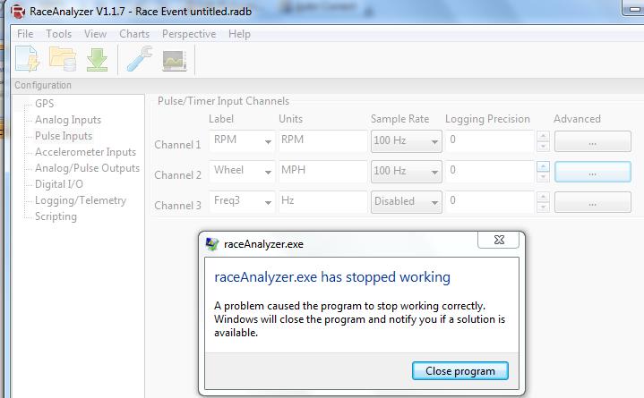

Now for the bad news, I just found a bug on the configuration part of Race Analyzer 1.17.0.
I was trying to setup a Pulse Input on Channel 2. Selected Frequency Mode with Clock Divider at CLOCK/8 and 1 pulse per revolution. (It's not just CLOCK/8, it also happens with CLOCK/2.)
When I pressed the increment button to increase the logging precision the program crashed. It also crashed when I manually type 2 into the dialog box.
I suppose I must have accidentally selected an invalid configuration, but it would've been nice to get a dialog warning me that the combination I selected is not a valid configuration.
Maybe the problem is that in Frequency Mode only 0 precision is valid?
