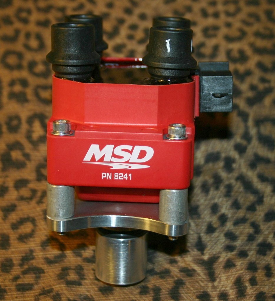

Don't use any black aftermarket coils, no matter how well they are advertised. They burn out after couple of weeks/month, non-reliable junk.
I was advised to use Red MSD coil PN# 8241 instead.
The aluminum base does not come w/coil. It is a Millers Mule Machine part made specifically for Lotus 910 Engines. http://www.manta.com/c/mmn4g16/millers- ... and-design
