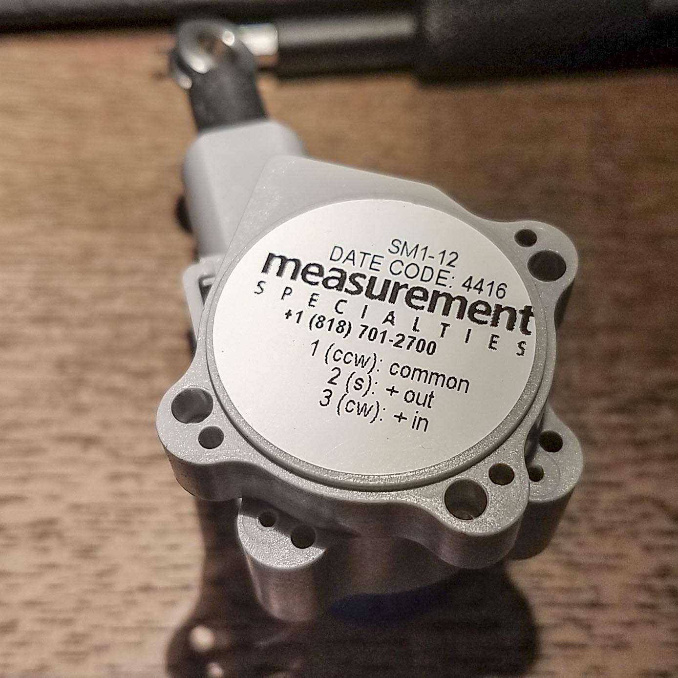

I gambled and took the unit apart.
#01 I'm talking about this guy.  I somehow broke the tensioner.

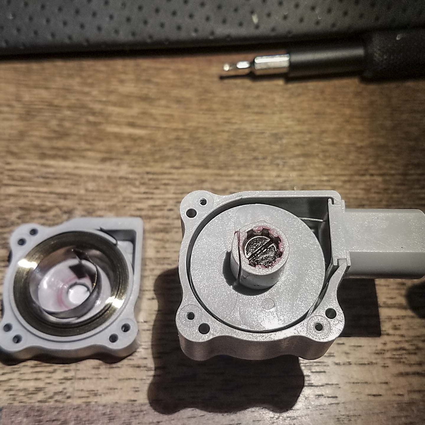

#02 Used a T5 torx driver and this is what I saw once I split it in half.

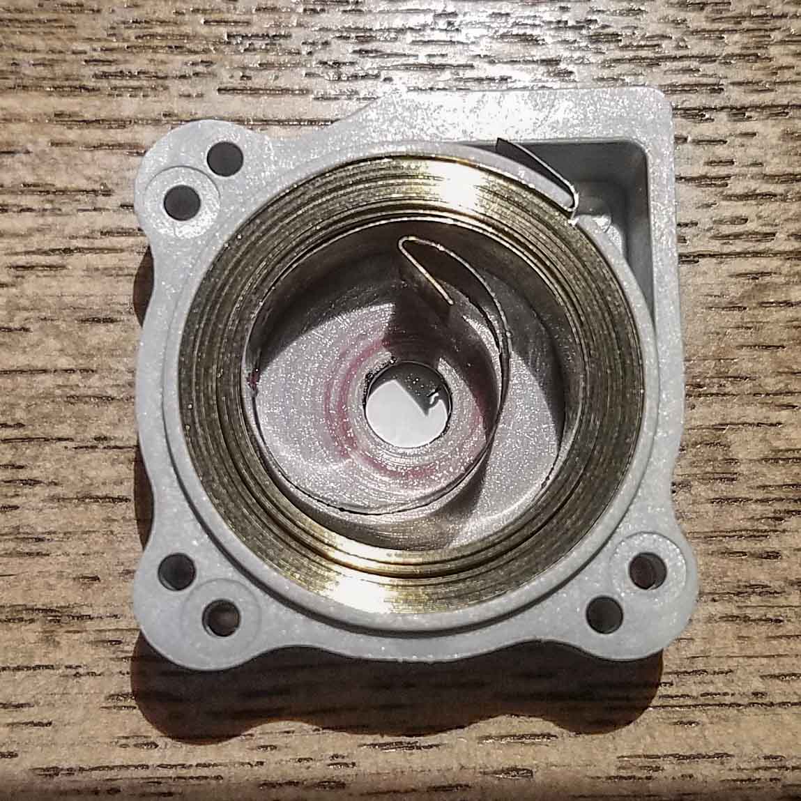

#03 What happened is the spring somehow disconnected from the shaft.

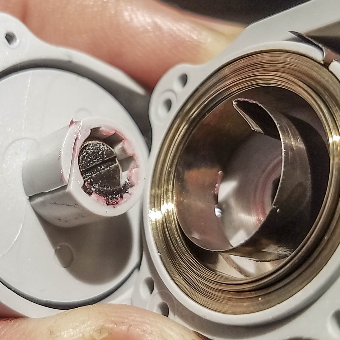

#04 The goal was to get the end of the spring back into the slot.  I lined them up like this and got the blade back into the slot.  Once the 2 halves were sandwiched together, I rotated the top half till the cable retracted all the way up.

brentp wrote:Oh no! was it like that as new, or did something happen to prevent it from being able to retract?
I was checking the range and felt the unit shimmy and spring release then no tension. It was very easy to fix. Ive gotten in 6 runs and unit is performing as designed.
