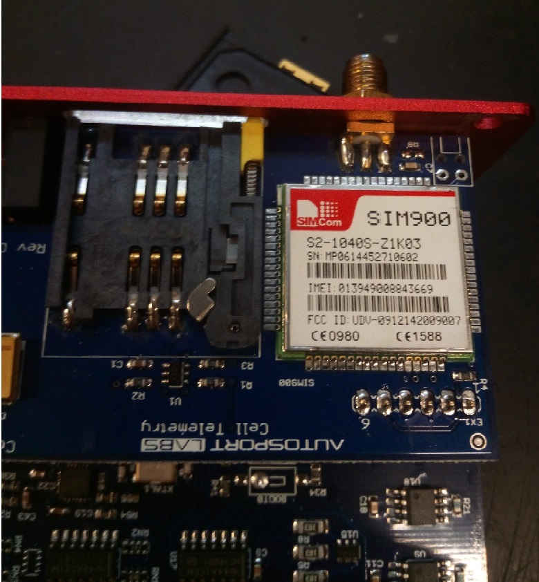

I am having trouble getting my telemetry working on a Racecapture Pro MK2 with a GSM module. (I believe it is the 2.5G type, can anyone confirm?)

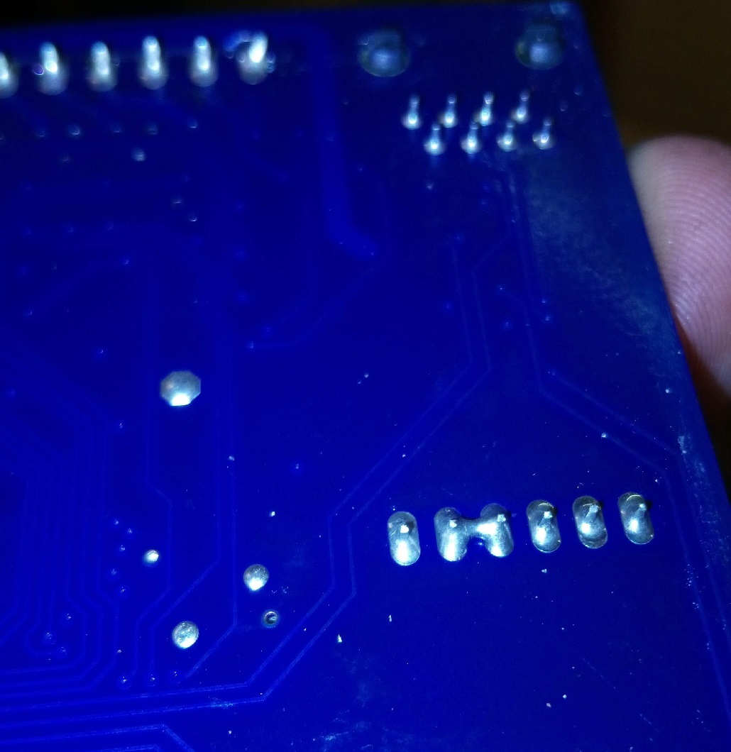

The RCP2 board has 2 pins soldered together going to the GSM module, can anyone confirm whether or not they are supposed to be soldered together?
I have attached pictures of both the GSM module and the soldered pins.
Underneath RCP2 PCB
Underneath RCP2 PCB
GSM module
GSM module
Those should not be soldered together. Can you try unsoldering it?

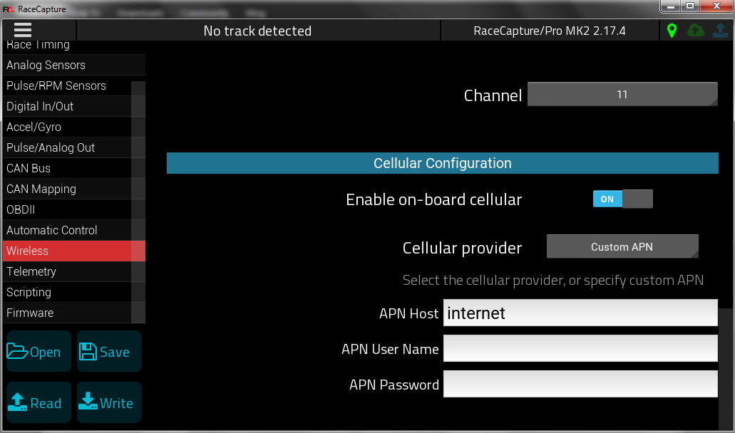

I have ensured that the cellular module os activated under Setup -> Wireless -> Cellular.
I have the correct APN acoruding to my cellular provider. I have Bluetooth and WiFi disabled to ensure they do not interfere with the GSM connection. i have disconnected the GPS antenna to make sure it doesn't interfere the the GSM antenna.

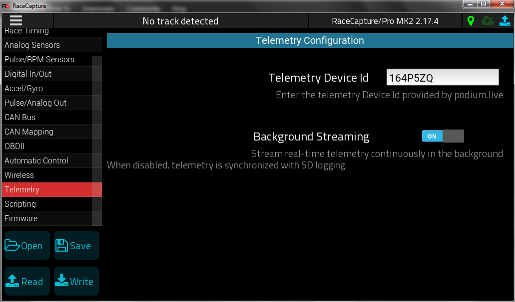

Under Setup -> Telemetry, I have background streaming enabled, and the correct Device ID

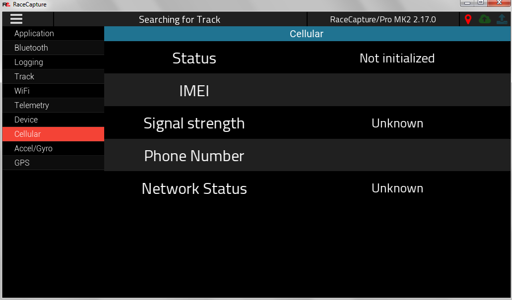

I have attached a picture of the window: System status - Cellular, which indaicated the cellular module has not been initialized.

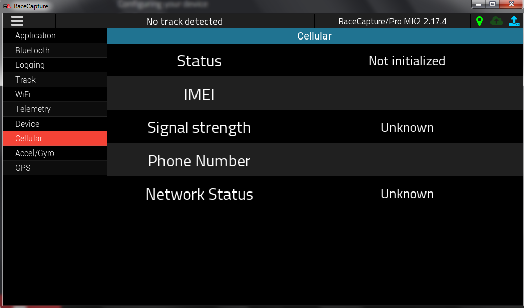

the racecapture app states the cellular module as not being initiallized, i have attached a screenshot.
I have enabled cellular ind the setup, and also enabled telemetry, sceenshots attached

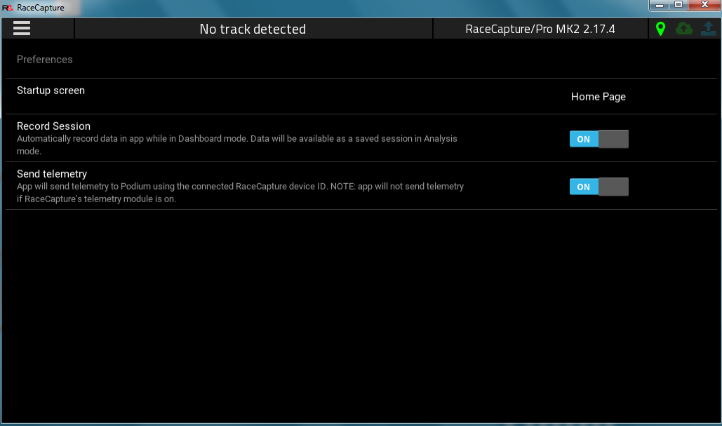

In the menu preferences, The "Send telemetry" is enaled, i don't know if this should be on or off?

Hi - the settings under App Preferences turns on broadcasting telemetry through the app - see the note under the setting.
If you don't have built-in cellular in RCP (or you don't want to use it) - you can turn this on.
If you're trying to use RCP's built-in cellular, you must turn this off.
Which way are you wanting to do this?
