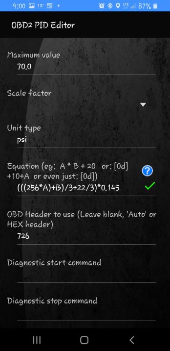

Can I get some help trying to get extended OBDII working? Ford Focus RS and trying to get TPMS data.
It works correctly with Torque using their default setting: PID 222813, equation (((256*A)+B)/3+22/3)*0.145
I'm using OBDII PID 10259,22h, CAN ID 2024, Offset 4 length 2 unsigned, big endian
I've also tried 29bit mode.
How do I debug this? I get no data (only 0's) I also see something about squelching that channel in the Info log. Not sure what that means.
Digger deeper, maybe I need to set the OBD header? In Torque it's changed from the default to 726 (hex I think). I don't think we have the option to change that in RC.
Of course I can't find any documentation on the Torque Pro extended PIDs.
It just says it has a header of 726. Other header values I've seen are "Auto" "ABS" "TCM" and blank.
Another value I've been sort of able to retrieve had a blank header, but the data received didn't match the expected values, but it sent back something.
Is there a simple lua script to send something out and monitor what comes back?
- Screenshot_20200521-090015_Torque.jpg (36.07 KiB) Viewed 27990 times
