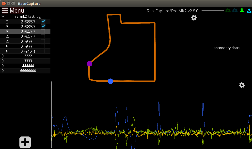

Here's a screenshot of the in-app analysis we're working on. The initial release you'll have an option to upload a log file, then later we'll add the ability to connect data streams from various sources. Initially, the analysis will be lap oriented - it'll look for incrementing LapCounts as a way to sub-divide the data into laps.
The theme for the analysis view will be similar to the dashboard view: arrows on the bottom of the screen will let you page between different analysis views while being able to select and compare laps from different sources. We're pretty excited about it!

- in-app_analysis.png (67.27 KiB) Viewed 17917 times
